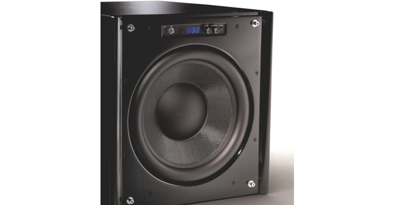

产品卖点
1, DD系列采用了TI TMS320 C2000平台数字信号控制器,该技术使得正常聆听情况下的典型失真率大大低于0.5%。
2
,采用CLASS D功放,功率超级强劲3000W(动态)/1250W(RMS)
3
,单元主要材料是Keclar,外圈为不同厚度的EPDM环绕
4
,采用3寸长双音圈设计
5
,低通分频点可以从15Hz-199Hz,容许作每1HZ的调整
6
,相位由0-180度,每15度一级微调
7
,8段EQ运算,在+6dB和-12dB之间逐小微调修正
8
,6组预设记忆播放模式

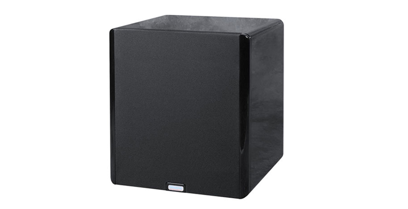

DIGITAL DRIVE PLUS Series
Specifications
DD 10 PLUS
DD 12 PLUS
DD 15 PLUS
DD 18PLUS
Amplifier:
(Class D)
3000 watts Dynamic
1250 watts RMS Power
3000 watts Dynamic
3000 watts Dynamic
3000 watts Dynamic
Woofer:
10” (24.5 cm)
12” (30.5 cm)
15” (38 cm)
18”
Frequency Response:
Overall
+/- 3 dB
10.5 – 300 Hz
18.7 – 120 Hz
10.2 – 300 Hz
17 – 120 Hz
9.0 – 30 Hz
14.6 – 120 Hz
8.8– 300 Hz
14.4 – 120 Hz
THD
<1%(typical)
<1%(typical)
<1%(typical)
<1%(typical)
High Pass Crossover
80 or 100hz at 6dB/octave
LowPassCrossover:
40 Hz – 199 Hz
40 Hz – 199 Hz
40 Hz – 199 Hz
40 Hz – 199 Hz
Phase:
0 to 180 degrees
0 to 180 degrees
0 to 180 degrees
0 to 180 degrees
Accessories:
Mic, mic stand and remote control
Dimensions (H/W/D):
(cm) with grille
15.25” x 12” x 16.375”
38.7 x 30.5 x 41.6
15.8” x 14.4” x 18”
40 x 37 x 46
20” x 18.1” x 12.5”
51x 46x 57
22.7 x 20.7” x 25.6”
58 x 53 x 65
Shipping Weight:
(approx)
75lbs. (34 kg)
85 lbs. (39 kg)
120 lbs. (54kg)
142 lbs. (64 kg)
